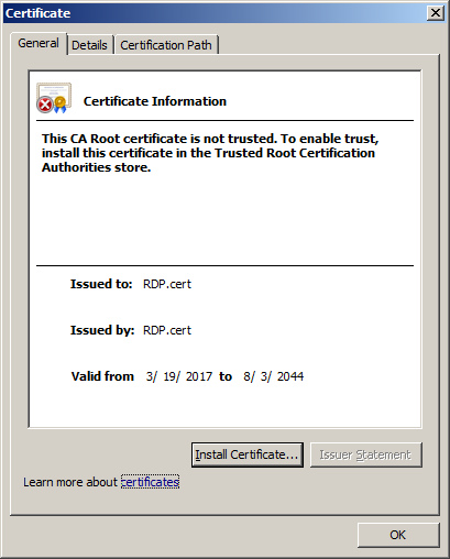

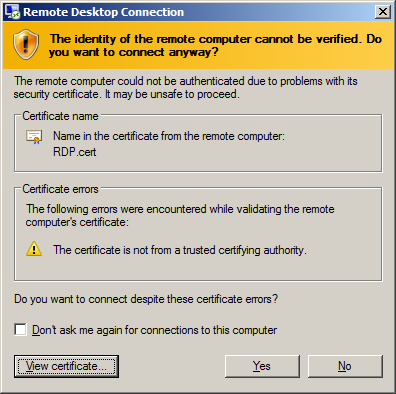

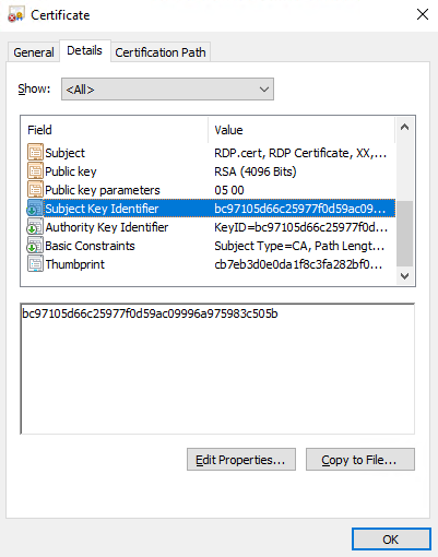

Simple 256 bit RDP cert (expires 8/3/2044) install
  1. Install RDP256.PFX (password=256) into computer default location.
  2. Run this command as admin:
    wmic /namespace:\root\cimv2\TerminalServices PATH Win32_TSGeneralSetting Set SSLCertificateSHA1Hash=“cb7eb3d0e0da1f8c3fa282bf096a00331276c679”
  3. restart remote desktop services or reboot
You can get a copy of the pfx file at:
https://zerofive.com/rdp256.pfx
Here are some screenshots of the cert in action:
