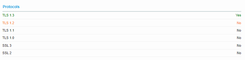

It looks to me like your site is running on TLSv1.3 fine, but isn't willing to speak TLSv1.2. I don't know if that's related to whatever you're seeing in your copy of Firefox, but it is rather unusual for a publicly-facing web site.
Then You were late. 20 minutes ago it would only accept TLSv1.2 laugh
