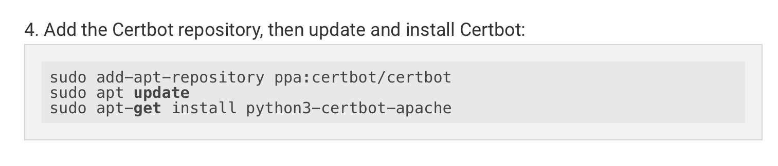

I recommend against the method to install Certbot from the tutorial you chose.
This should be your first choice snapd
And if you cannot use the first choice here is the second choice pip
