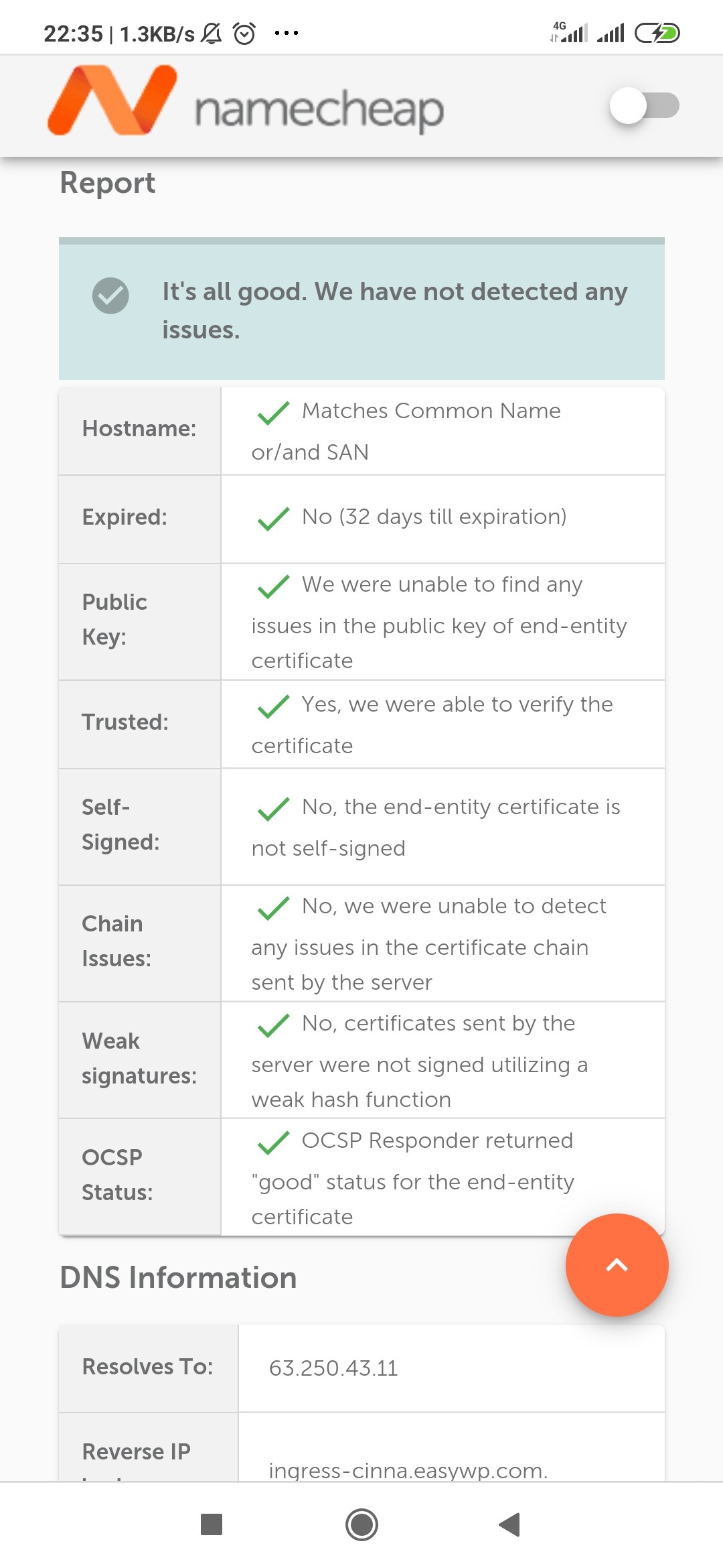

This page shows that the certificate is supposed to be working fine(even though its not)
