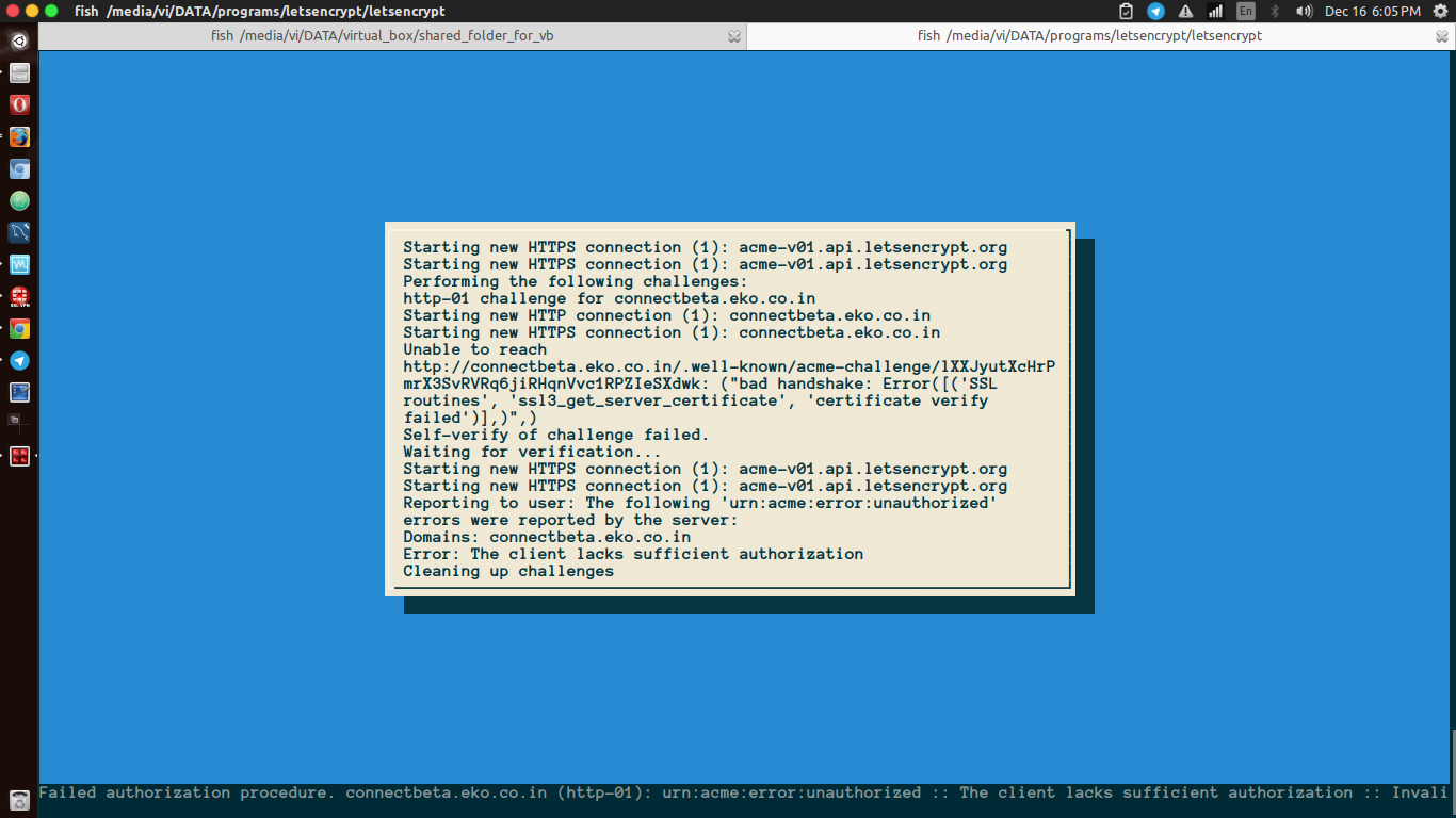

I have tried generating the keys & certificates using the below command. But I’m getting error.
`vi at vi-Inspiron-7537 in /m/v/D/p/l/letsencrypt
./letsencrypt-auto --agree-dev-preview --server https://acme-v01.api.letsencrypt.org/directory certonly -d connectbeta.eko.co.in -v -a manual
But I am getting the below error.
Failed authorization procedure. connectbeta.eko.co.in (http-01): urn:acme:error:unauthorized :: The client lacks sufficient authorization :: Invalid response from http://connectbeta.eko.co.in/.well-known/acme-challenge/lXXJyutXcHrPmrX3SvRVRq6jiRHqnVvc1RPZIeSXdwk [59.162.104.10]: 404

You're automatically redirecting to https. The http challenge needs to be conducted over http, not https. Turn off the https redirect and try again.

The log also says: "certificate verification failed".
So.. The question is. What kind of HTTPS site is running at the moment?
Ah, I see the problem: SSL Server Test (Powered by Qualys SSL Labs)
SSL Report: connectbeta.eko.co.in (59.162.104.10)
Certificate name mismatch
connectalpha.eko.co.in
Your "beta" server is serving the certificate for "alpha".. That's not gonna fly with Boulder.

Hmmmm… I just read that message.
Perhaps you’ve missed my post above, but your server is serving the wrong self-signed certificate. It serves the “connect alpha” certificate, not the “connect beta”. That’s why the client gives a certificate verification error and can’t verify the challenge.
