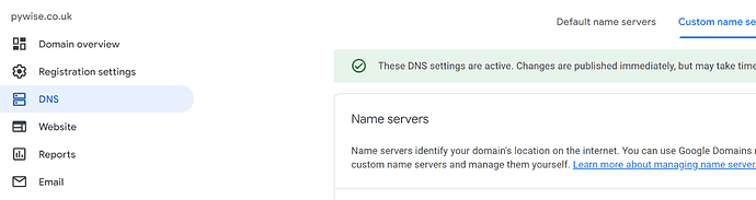

The only thing I saw regarding the custom name servers is:
I tried to hook my domain to Google cloud DNS (and Compute engine behind that)
I'm not sure what this means or how that's an actual reason for the use of custom name servers.
Let's step back a little bit: Of which control panel of what service is this screenshot? Please be as exact as possible. (E.g., not just "Google".)

Ah I see that google cloud dns and domains are separate but similar (at least NS-wise) things. It looks like you're working with google domains panel instead of google cloud dns panel.
yes. I am creating certificate for domain. So I am wrong then?
You have to make these records in the panel that actually controls dns records for the domain, in your case: cloud dns.

See where I am changing

If I search for "google cloud DNS control panel" with Google Images, I'm getting pictures of control panels which are NOT looking like the control panel of your screenshots.
As @Nekit I suspect you're using the DNS zone editor of Google Domains, but your custom name servers are of Google Cloud.
If you don't have any good reason to use custom name servers to begin with, I certainly would switch back to the default name servers. If you still have the CNAME set up correctly, your setup should work. If you've removed the CNAME record, then you should add it again as previously recommended.

When using acme-dns and you're using Google Domains as nameservers (and do NOT have Google Cloud nameservers configured for your domain) then yes, you should put the custom record as CNAME in your "Default Name Server" editor.
However, if you're using custom name servers, you should add that CNAME record at the DNS zone editor of those custom name servers, which in your case appears to be Google Cloud (which is different from Google Domains).

I am using custom name server. It is true
I am assuming, I can add another CNAME record set in Google cloud Zone (NOT Domains). But what will be the DNS name ? type is CNAME (OK) and what about cannonical name ?

If you have Google Cloud nameservers set up as the authorative name servers for your domain then yes, you should add the CNAME record in the Google Cloud zone.
It would be exactly the same as in your Google Domains zone editor.
If the CNAME is set up correctly finally, then yes, it should work.

That should be the value you got from the acme-dns-auth.py script. I.e., the long hostname ending with .auth.acme-dns.to.
Thank you and DNS name empty or www ? ( I presume it is _acme** sorry for a daft question)
No, not empty or www. You have posted multiple screenshots of the instructions of the script already where it says to add the CNAME for _acme-challenge.pywise.co.uk.

I see you've managed to correctly set up the CNAME record and got a certificate :slight_smile:
