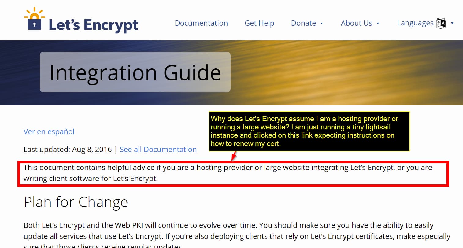

While the email may provide what I need to know, it is not written in a way that is useable for me and, I suspect, a LOT of other people.
To show what I mean, I've annotated what I thought upon reading the email in a screenshot of the email.
Ultimately, the biggest problem is that the FIRST link they provide is a link to their "Integration Guide". I had fully expected to see something related to what I need to do to fix my problem (like, "how to renew"). But it was just a long doc intended for "hosting providers"-- why !?
The sentence immediately before the link to the Integration Guide is...
"For Let's Encrypt's current 90-day certificates, that means renewing 30days before expiration."
That would lead ANYONE to believe that the following link will address "how to renew", but it does anything but that.
By the time I got through realizing that the "Integration Guide" has nothing to do with me, my frustration was high and I went to the forum link and posted my question. I assumed that the last link would be more of the same and I didn't go there until later.
So, that's my feedback. I think if the email skipped the "Integration Guide" link and just provided basic info for people who do not deal with certs on a daily basis it would be much better.
