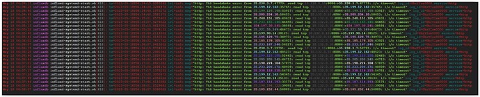

Instale cerbot para acceder mediante SSL a influxdb y en el log de influxdb da siempre el siguente mensaje cada pocos segundos.
│May 17 13:37:07 influxdb influxd-systemd-start.sh[1069111]: ts=2023-05-17T13:37:07.939909Z lvl=info msg="http: TLS handshake error from X.X.X.X:YYYYY: read tcp 10.132.0.10:8086->35.233.167.246:58083: i/o timeout" log_id=0hrKf~o0000 service=http donde X.X.X.X es una direccion IP e YYYYY es un puerto y ambos van cambiando...
Sí que accedo en el navegador https://influx.w2.enkrott.com
¿por que me da estos mensajes? ¿solucion?

That looks like a communications timeout error and not a problem with the certs. Most likely some sort of firewall maybe blocking port 443 from the public internet?

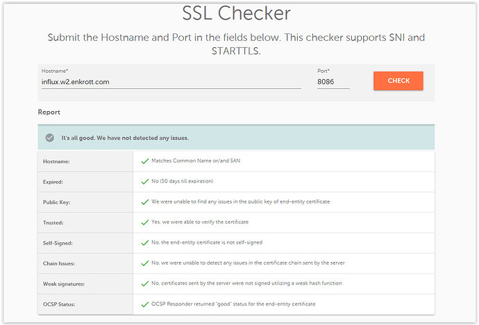

You say you can reach the website with https://influx.w2.enkrott.com/ but I cannot. Could this be the problem? See this SSL Checker website which also cannot see that domain using HTTPS
I’m sorry, https://influx.w2.enkrott.com:8086
I run SSL Checker and All is Ok.
Do you recognize that "X.X.X.X" IP?
It may be some hacker/scanner IP.

They are all ips from google; My proyect is in Google Cloud.
am i being attacked by hacker on google?
how can I solve that?
I dont know; My proyect is in Google Cloud and I am receiving many request of IPs of Google..
Hacker?

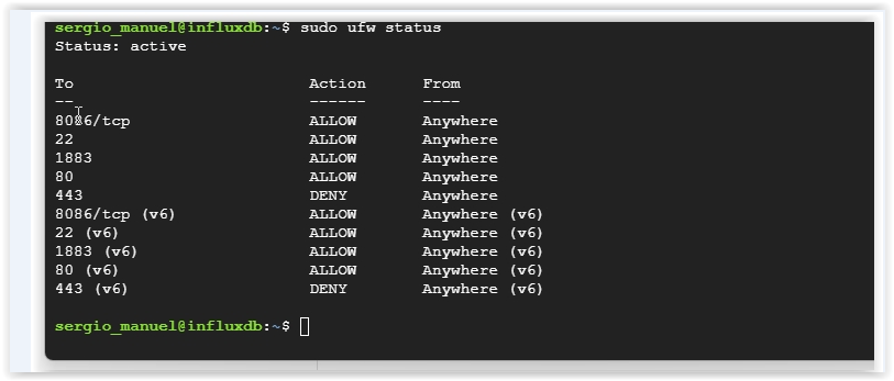

Q#1: Do you have a firewall?
Q#2: Do you know how to use the firewall?
I can close port 80, but Cerbot uses it for the certificate, right?
Yes, I have two Firewalls: Google Cloud y ufw in linux Linux.
I have open ports 80, 8086 (server inflxudb), 1883 (mqtt), 22 (ssh) icmp, all port for virtual machine for my proyect in GCP
Why?
[you are allowing them to connect]
Because I connect to https://influx.wave2.enkrott.com:8086. This port is the default port for influxdb
That's an influxdb "info" level entry. You should ask about this on an influxdb forum.
Many services have nearly useless "info" level entries and adjusting the log level suppresses the messages. And, many times they are just nuisance messages. Now, this does seem like something that might be a problem. But, again, a forum of influxdb experts are best to advise you.
I don't have any trouble accessing that domain:port which shows the certs are fine. A timeout problem can be caused by a wide variety of things.
