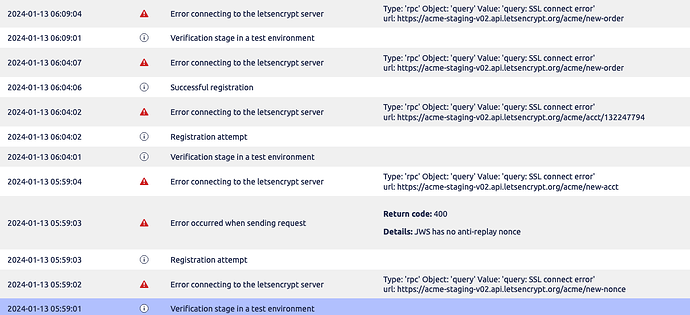

We are experiencing problems issuing certificates on ISPmanager. Same error. Many users with this error found that their IP addresses were blocked by LE. Is it possible to check ours?
My domain is: ekrasavin.pp.ua
I ran this command: ISPmanager LetsEncrypt module
The operating system my web server runs on is (include version): Almalinux 8
I can login to a root shell on my machine.
I'm using a control panel to manage my site.
IP - 23.111.120.111
I attach a screenshot of the certificate issuance errors.
On another server - 23.111.123.17, with the same panel version and OS, everything works fine.

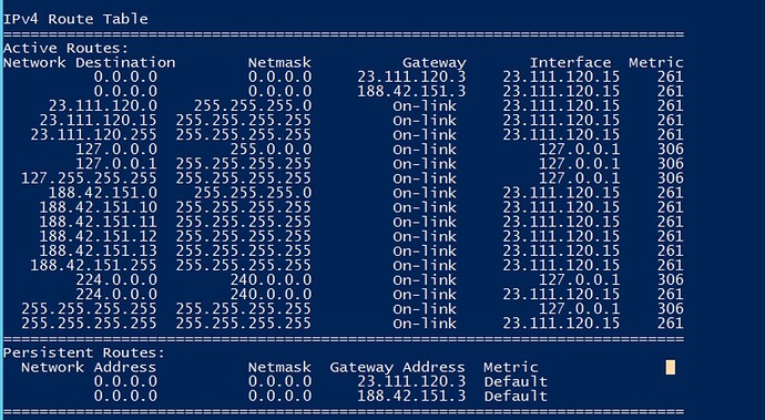

route print
I have a similar problem on subnet 188.42.151.0\24. linux and windows
On the windows server machine on subnet 23.111.120.0\24 seems to be working already.
You have two default gateways:
Is that expected?
Yes, I'm trying to change the IP address to a different one.
I want to keep the 2 subnets working for a while until I make sure all my clients have changed IPs in their domains.
Right now, none of my Windows servers are running certificate issuance on both subnets anymore
on linux server 23.111.120.111 also stopped issuing certificate
You only have one IP on that system: 23.111.120.15
[there is no second IP]
