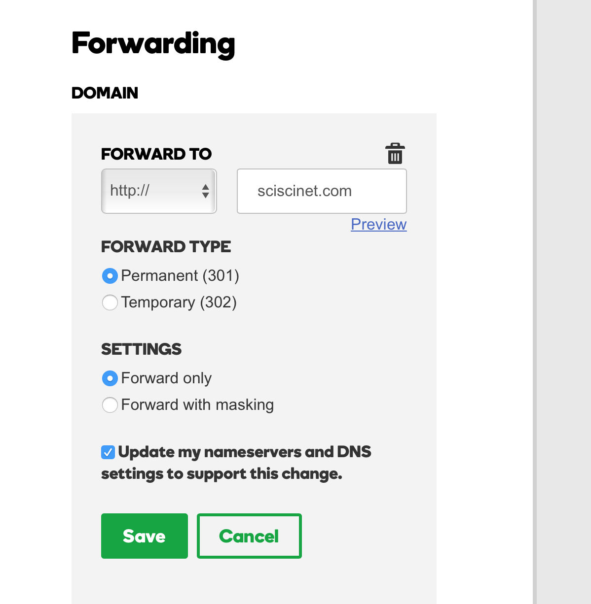

I don’t know where the \ come from. The Forwarding image is shown as following:
At the moment, GoDaddy domain forwarding stuff isn’t being used. (And it probably shouldn’t be used.) Nginx on 54.95.211.21 is returning the strange redirect.
Hi Thanks! Now the IP information is changed to ‘Forwarded’ as shown in the image. I don’t know why or another row(A type) is deleted .
