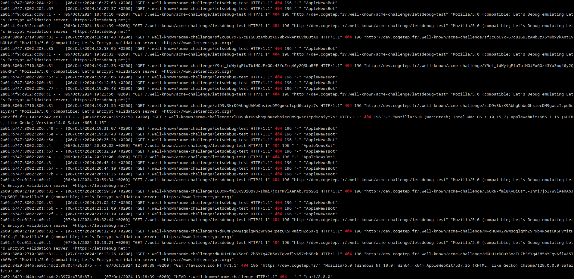

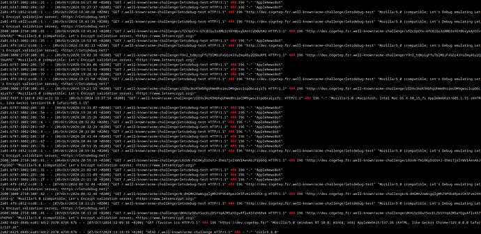

The problem is the failure of the ACME challenge (extract from access_log below).
Why is that a problem? It's normal for challenges that do not exist (due to the testing nature of the challenges you've shown) to return a 404 file not found.
It's only a problem if you're actually having issues with obtaining or renewing your certificate.

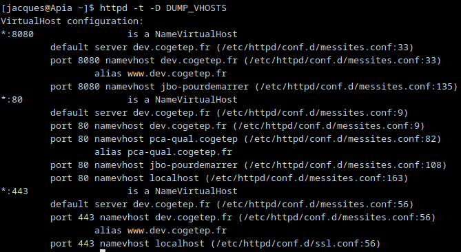

What shows?:
sudo apachectl -t -D DUMP_VHOSTS
Hello OSIRIS.
I have a problem understanding the fund. Can you please precise "due to the testing nature of the challenges I've shown".
04d httpd_DUMP_VHOSTS_20241007
Often requests for challenges will get to your webserver which are NOT from Let's Encrypt. For example, Google bot will recognise the challenge URL from e.g. this thread and will try to get it. But in the mean time, that challenge is already gone, because it's not used by Let's Encrypt any longer. So your webserver will reply with an expected 404 file not found.
Only if Let's Encrypt requests a challenge when you're obtaining or renewing a certificate, THEN are the challenge requests in your log important. The others you can ignore.
Thank you OSIRIS for these enlightening details.
So I have to understand that there is no Let's Encrypt problem. That the error message returned by Let's Debug is linked to the fact that the domain dev.cogetep.fr is inaccessible in IP v4 from the internet (I will check this point with my internet operator).

What shows?:
what is wrong with this line?
In order to tell you what may be wrong...
We first need to see that file.
Here is the file messites.conf
