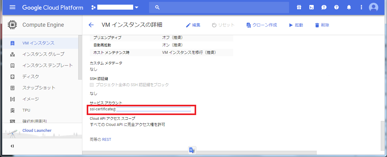

Next, I checked the next page and created a service account.
https://certbot-dns-google.readthedocs.io/en/latest/
Next, when I ran the dry-run linking the service account to the GCE instance, I failed.
-> gcloud auth activate-service-account ssl-certificate@xxxx.iam.gserviceaccount.com --key-file /tmp/dns.json --project test
However, if you originally attached a service account to GCE, dry-run will succeed.
