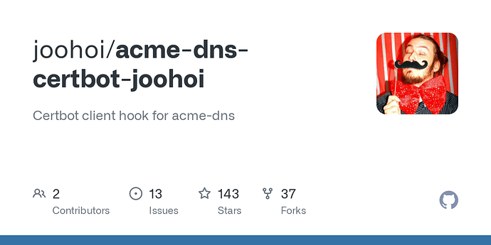

Did you read my post above about acme-dns?
:wink:
I did, I'll have a look, seems like some gyrations of mouth holding would take place. Might be a clue in there, if willing to allow 3rd party DNS mods. We shall see.
