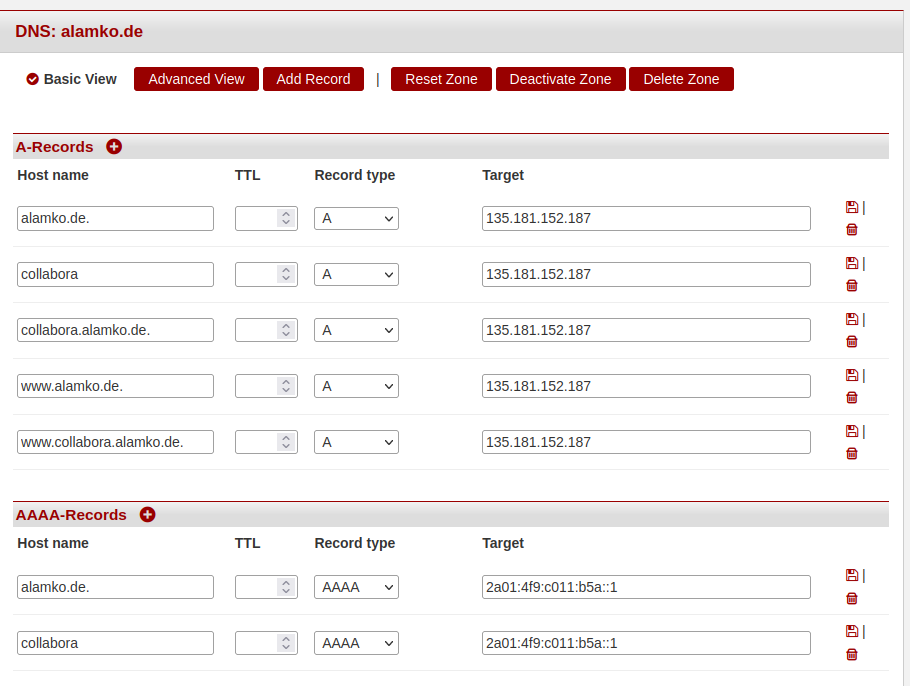

Is the host running your nginx actually 135.181.152.187 and 2a01:4f9:c011:b5a::1?
Is there a firewall?
Those are them:
How do I check this?
Seems I don't have one, by the GUI at least
