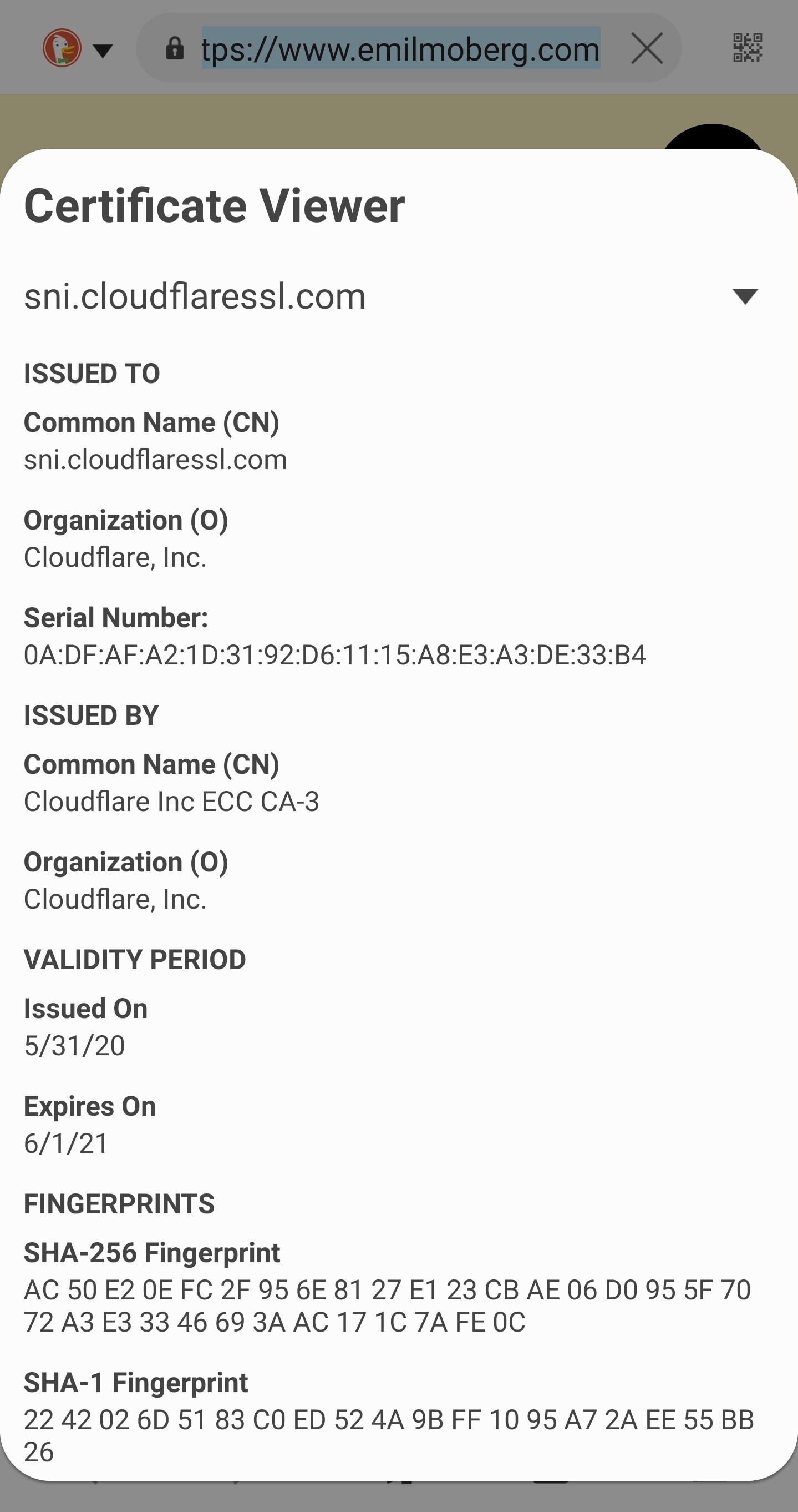

I ran into the same issue I ran into last time a couple months ago. At that time, I solved it by changing nameservers from cloudflare to digitaloceans nameservers, and disabled https redirects from nginx server blocks (back to how it was when I first created the certificates...)
That was a hassle, but it did not fail then.
(My certificate emilmoberg.com contains domains emilmoberg.com and www.emilmoberg.com)

I also use the cloudflare TLS/SSL.
