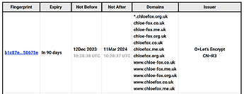

Starting point:
- Both the ChloeFox and SK certs rotated successfully this morning after deselecting all name options except the base CN. These certs include the full name list
- Both ‘full load’ certs were issued even though the renewals were requested as only the unqualified CN. What is Plesk doing here??

Now moving on to the ChloeFox cert:
ChloeFox all options > Asked me to update the _acme-challenge to the existing value. That’s a third time now. > Failed: Detail: Error finalizing order :: Rechecking CAA for "chloe-fox.org.uk" and 10 more identifiers failed. Refer to sub-problems for more information
ChloeFox unqual. CN only >
Attempt 1: Detail: Error finalizing order :: Rechecking CAA for "chloe-fox.org.uk" and 10 more identifiers failed. Refer to sub-problems for more information – Note "chloe-fox.org.uk" was not requested in the Plesk UI
Attempt 2: Detail: Error finalizing order :: Rechecking CAA for "chloe-fox.org.uk" and 10 more identifiers failed. Refer to sub-problems for more information … but issued the cert in only the unqualified CN … so says it fails, actually worked, and actually resulted in only the single unqual name as requested
Attempt 3: Reports success. Single unqualified CN only
ChloeFox unqual + www principal names only > Success as requested only. Not full load
ChloeFox principal wildcard > Success as requested only. Not full load … but asks for the _acme.challenge to be updated to the existing value. 4th occasion for this now.
ChloeFox request full load > asks _acme.challenge to be updated to the existing value. 5th occasion > Detail: Error finalizing order :: Rechecking CAA for "chloe-fox.me.uk" and 11 more identifiers failed. Refer to sub-problems for more information
ChloeFox full load > Detail: Error finalizing order :: Rechecking CAA for www.chloefox.co.uk and 11 more identifiers failed. Refer to sub-problems for more information
ChloeFox full load minus chloefox.co.uk (reported problem) > Detail: Error finalizing order :: While processing CAA for chloefox.co.uk: DNS problem: SERVFAIL looking up CAA for chloefox.co.uk - the domain's nameservers may be malfunctioning … note inclusion of the chloefox.co.uk even though de-selected
ChloeFox full load - chloefox.co.uk (reported problem) > Detail: Error finalizing order :: Rechecking CAA for www.chloefox.co.uk and 11 more identifiers failed. Refer to sub-problems for more information … again, note “chloefox.co.uk” was excluded from the cert request
ChloeFox principal wildcard > Detail: Error finalizing order :: Rechecking CAA for "chloe-fox.org.uk" and 11 more identifiers failed. Refer to sub-problems for more information … note chloe-fox.org.uk was again excluded from the request
