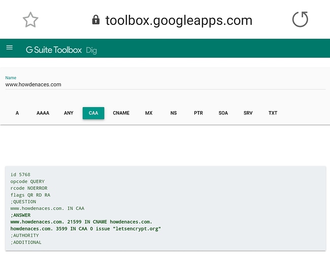

I tried it again and now I'm getting a CAA record error instead. How do I resolve this? Or is this still a DNS problem that I'll have to wait out?
Domain: www.howdenaces.com
Type: dns
Detail: DNS problem: SERVFAIL looking up CAA for www.howdenaces.com
- the domain's nameservers may be malfunctioning

I just ran quite a few tests on your DNS zone looking up the CAA for www.howdenaces.com via the CNAME to howdenaces.com. In all but one of my trials a correct CAA record was returned. I also got passing results from letsdebug.net for www.howdenaces.com and howdenaces.com. You have clearly hit the Failed Validation limit on the Let's Encrypt production server. This rate-limit clears very quickly so try the following when you can:
sudo certbot renew
There is a Failed Validation limit of 5 failures per account, per hostname, per hour. This limit is higher on our staging environment, so you can use that environment to debug connectivity problems. Exceeding the Failed Validations limit is reported with the error message
too many failed authorizations recently.

Considering this is still an issue, I would suggest contacting Digital Ocean's support.
You can provide this command to reproduce the issue:
dig +trace www.howdenaces.com
