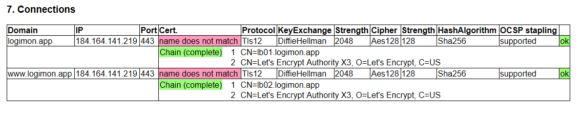

Checked that domain there are some certificates ( https://check-your-website.server-daten.de/?q=logimon.app#ct-logs ):
Let's Encrypt Authority X3 2019-08-03 2019-11-01 lb02.logimon.app - 1 entries duplicate nr. 1
Let's Encrypt Authority X3 2019-08-03 2019-11-01 lb01.logimon.app - 1 entries duplicate nr. 1
Let's Encrypt Authority X3 2019-08-03 2019-11-01 *.logimon.app, logimon.app - 2 entries duplicate nr. 2
Let's Encrypt Authority X3 2019-08-02 2019-10-31 *.logimon.app, logimon.app - 2 entries duplicate nr. 1
But your standard urls use wrong certificates:
• http://logimon.app/
184.164.141.219 200 0.297 H
• http://www.logimon.app/
184.164.141.219 200 0.303 H
• https://logimon.app/
184.164.141.219 200 5.053 N
Certificate error: RemoteCertificateNameMismatch
• https://www.logimon.app/
184.164.141.219 200 4.210 N
Your connections:
Your non-www uses the lb01, your www uses the lb02 certificate, both are wrong.
Looks like your setup is too complicated. The only thing you need is one certificate with *.logimon.app + logimon.app. You can use that certificate internal with your non-www and your www-domain and with both loadbalancers.
So you have already one correct wildcard certificate. Then use it.
