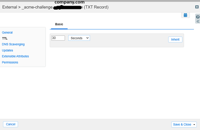

My issue is when I add the _acme-challenge.ap.company.com. to my DNS server (this is IPAM tool).. it has always expired timout.. Who can help me

It is not our real company name. is it really necessary ? the issue TTL period. When I change from IPAM , command prompts already expired

If you tried and aborted the process, you may have left behind old ACME DNS records. I suggest you clear any such entries off your zone before you attempt to run it with extended delay for the zones to be published and propagated. Also worth noting LE always reaches my secondary and never my primary DNS server - unsure if I'm that lucky or it is by design, so aside of the IPAM record publication, you also need to account for the zone synchronization while setting up your timeout. If using certbot with DNS RFC2136 hook (recommended for ISC BIND based setups), refer to its parameters, of importance the "--dns-rfc-2136-propagation-seconds" to increase it accordingly.
Edit: I see you are using manual DNS, so before you press continue, make sure you can query the _acme-challenge record at all your DNS servers.
For DNS validation when you create/update a TXT record you need to wait long enough for the changes to be copied to all of your domains nameservers before proceeding, normally that's a minute but it can be up to 5 minutes, then resume your certificate order. TTL settings don't matter because Let's Encrypt is looking at your primary nameservers not cached stuff like 8.8.8.8
Manual DNS validation is very error prone (and are not automated) and you should ideally use an automated DNS plugin where possible.
