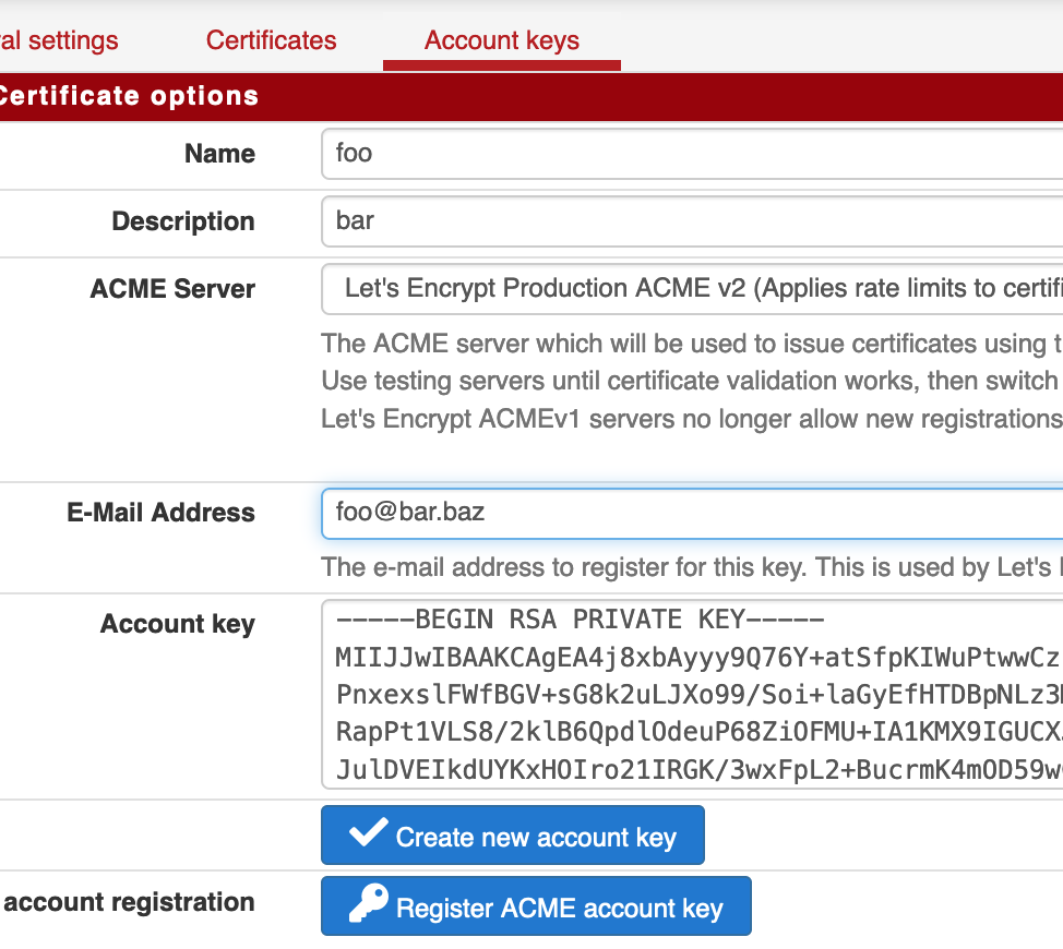

This really seems like a question that'd be better on the pfSense forum than here, but in brief, you'd start by creating a new ACME account key on the production server, and then use that to create the desired new certs.
Agreed.
I wouldn't know where to begin searching for the "staging" setting in pfSense.
Right here:
(don't worry, the key in the image isn't actually in use at all).

Once you've set up the production key, you'll need to edit each cert that was issued from the staging environment, switch it to the staging production account key, and then reissue the cert.

Who said anything about import? Edit the existing cert--that's what the "pencil" button does. Set it to use the production key. "reissue" the cert. Repeat for each cert that needs to be changed.
Thanks I think I got it - what didn't work yesterday seemed to work today. Go figure.
