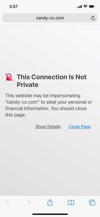

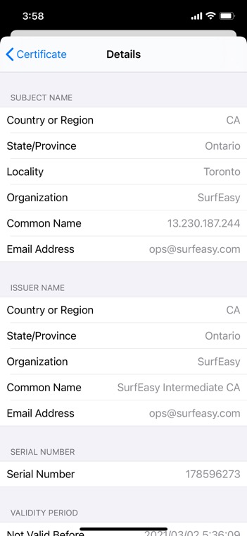

Now, there was an error on my site, so I took a screen shot.
Do you know the problem with this?

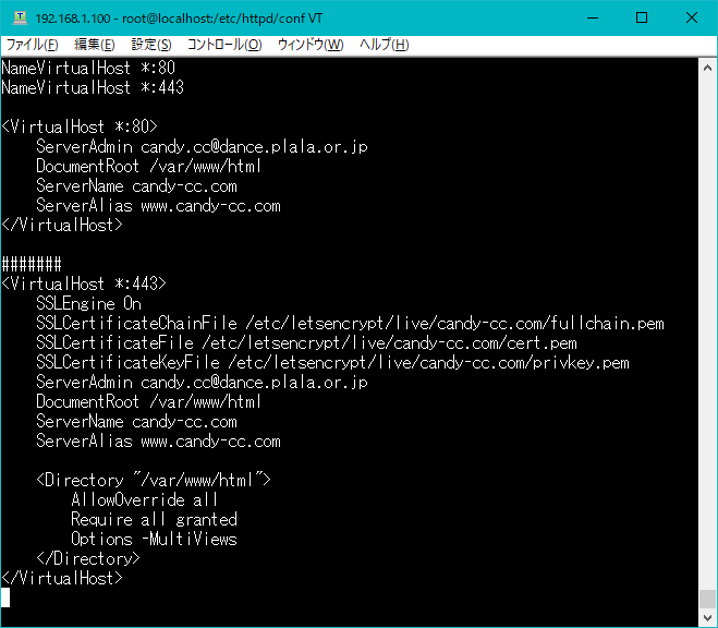

This screenshot is "httpd.conf".

The HTTPD file contains a virtual host for port 443:
[abbreviated]
<VirtualHost *:443>
    SSLEngine On
    SSLCertificateChainFile /etc/letsencrypt/live/candy-cc.com/fullchain.pem
    SSLCertificateFile /etc/letsencrypt/live/candy-cc.com/cert.pem
    SSLCertificateKeyFile /etc/letsencrypt/live/candy-cc.com/privkey.pem
    ServerAdmin candy.cc@dance.plala.or.jp
    DocumentRoot /var/www/html
    ServerName candy-cc.com
    ServerAlias www.candy-cc.com
    <Directory "/var/www/html">
        AllowOverride all
        Require all granted
        Options -MultiViews
    </Directory>
</VirtualHost>
