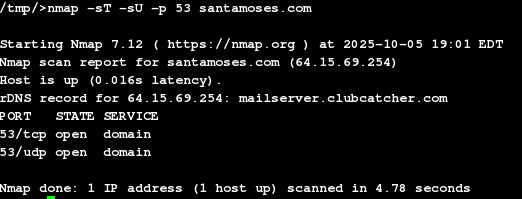

I ran a test on the unregistered domain and nmap tells me the TCP and UDP port are open.
Is there a specific IP I should whitelist in my firewall for letsencrypt to function normally?
Did you look at the DNSViz report for santamoses: santamoses.com | DNSViz
Look especially at the Warning messages about the mis-matched name servers
I assume you intend the DNS to be configured in a similar way as your other domains. This is a good place to start in fixing your problem.
Let's Encrypt walks the authoritative DNS tree so any path that is configured must produce the right result
I am not sure that is the whole problem here but it is one you should fix.
