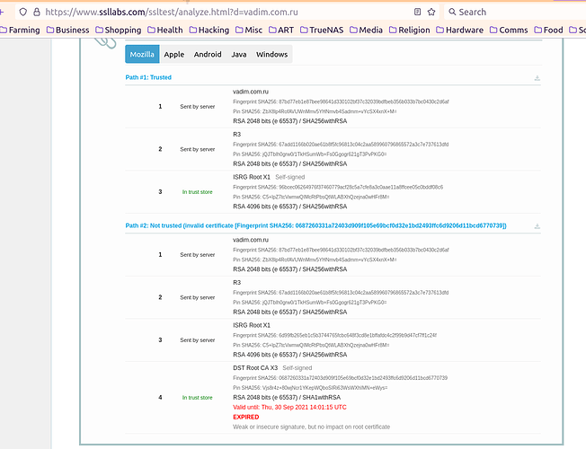

Verify error:num=20:unable to get local issuer certificate

It was auto-populated and I figured it out, Since I was helped with my certs shall we try and fix the OCSP Stapling again? I can uncomment those lines and reproduce the error.

I did that and restart nginx - no errors but on the test it shows no stapling?
"OCSP Must Staple" is a property of the certificate and does not signal if your server actually send a stapled OCSP reply.
Try connecting to your site with OpenSSLs s_client and add the -status option: at the top it'll show you an OCSP reply if stapled. If not stapled, it won't return an OCSP reply.
FYI: I see the stapled OCSP reply :slight_smile:
Right - it's right here
