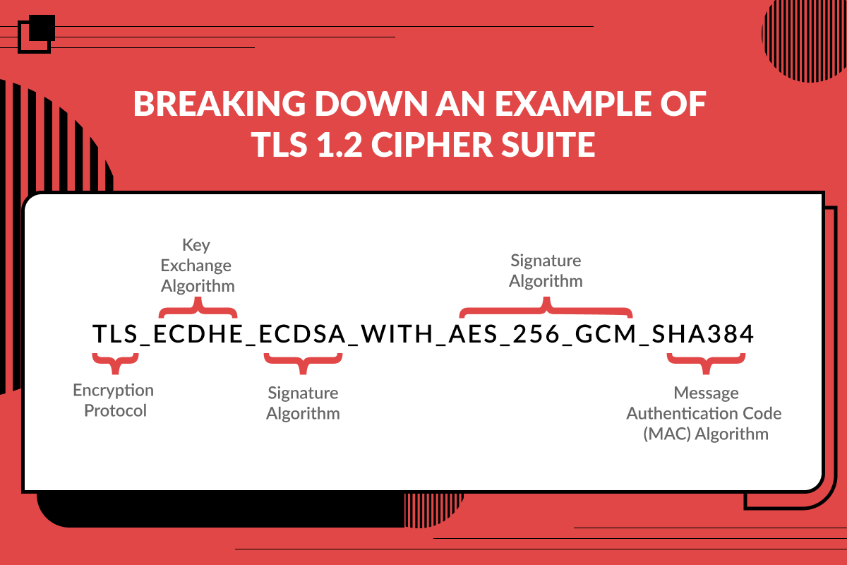

Just for info, if your own site has a certificate using an RSA public/privatekey pair then the client communication (Qualsys talking to you) uses a cipher suite that includes RSA. If you used an EC key instead for your own cert then the cipher suites negotiated would be different (ECDSA).
From https://www.domain.com/blog/what-is-cipher-suite/
