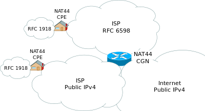

In principle there are also many systems that are IPv6-only or IPv4-only. Also with some models of carrier-grade NAT
the clientâs ISP is essentially making this decision for it.
