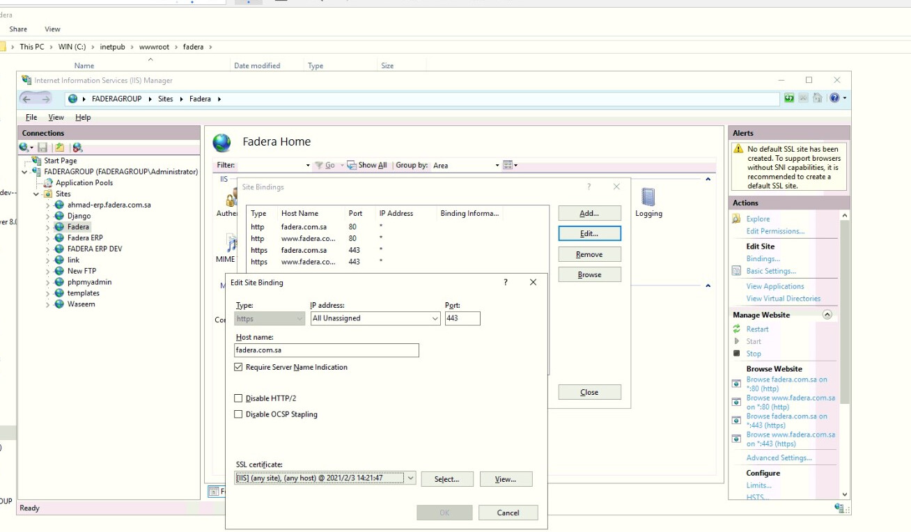

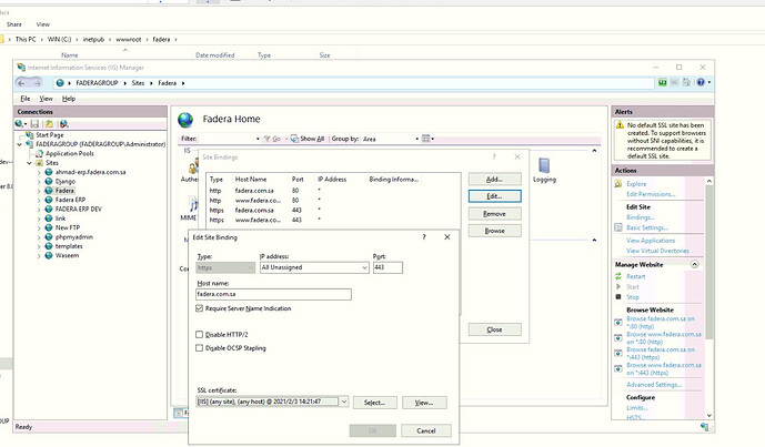

Looks like this certificate isn't installed.
So update your binding manual.
This is the same binding that worked before yesterday.
do you see any problem in here ?
This is the tool i used to create the certificates.
this tool creates and attach certificates to iis automatically.

Works https internal, from that machine?
curl https://fadera.com.sa/
Looks like its not.
That's a Windows 10, not your server with Windows 2012.
Appologies not 2012 but 2019 as it says here right.
and here is my port opened.
You have something that blocks. Find that and remove it.
