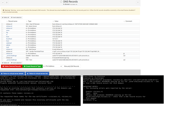

sudo certbot certonly --manual --manual-auth-hook /etc/letsencrypt/acme-dns-auth.py --preferred-challenges dns --debug-challenges -d nlclass.nl
I forgot to add *.nlclass.nl, so when I tried this command again I get an error:
sudo certbot certonly --manual --manual-auth-hook /etc/letsencrypt/acme-dns-auth.py --preferred-challenges dns --debug-challenges -d nlclass.nl -d *.nlclass.nl
Existing certificate that contains a portion of the domains you requested (ref: /etc/letsencrypt/renewal/nlclass.nl.conf). It contains: nlclass.nl
Domain: nlclass.nl
Type: none
Detail: DNS problem: NXDOMAIN looking up TXT for _acme-challenge.nlclass.nl -check that a DNS record exists for this domain

(Anyhow, you should use single quotes around wildcards -d '*.nlclass.nl' otherwise your shell might get in the way)
I also think those in the screenshot aren’t your actual dns records: are you configuring the right nameservers?
And even if they were, you can’t set a TXT record where you already have a CNAME, the TXT record will (should) get ignored

"I also think those in the screenshot aren’t your actual dns records: are you configuring the right nameservers?"
--> Yes, I set those exact DNS records from the printscreen.

No, that's not a file, that's the output of a tool that queries dns servers.
ABSOLUTELY NOT.
If you're using acme-dns, you should only have a CNAME record like this:
_acme-challenge 3600 in CNAME somethingsomething.auth.acme-dns.io
If you're going to use your provider's API (digitalocean should be supported by most clients, and by certbot in particular) you should have nothing on _acme-challenge, because the client will create and destroy the records when it needs to do so.
But you should really make sure that those are your actual dns records, because they look really different to me. Where are you editing them from?
"where are you editing them from"
--> From VirtualMin, an app in the Digitalocean control panel. URL: https://host.nlclass.nl:10000/virtual-server/list_records.cgi?dom=159710724121633&xnavigation=1
"If you’re using acme-dns, you should only have a CNAME record"
Yes, in the printscreen there is only 1 CNAME record. After I got the error message which says:
NXdomain looking up TXT for _acme-challenge.nlclass.nl - check that a DNS record exists for this domain
I then added a TXT record, which didn't help. I will remove the TXT record now.

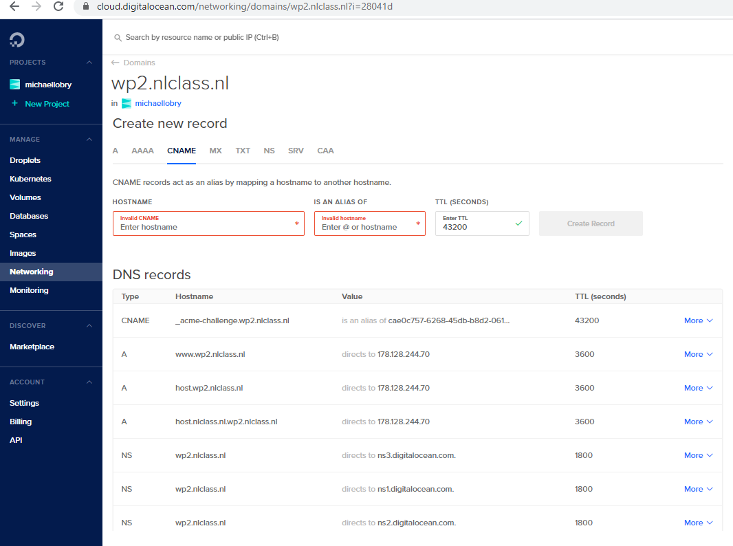

–> ok. I just now set the following DNS records. See printscreen.
Is this correct?
This looks better, but I’m not sure what you’re trying to do.
That looks like you’re trying to get a wildcard for *.wp2.nlclass.nl

" This looks better, but I’m not sure what you’re trying to do. That looks like you’re trying to get a wildcard for *.wp2.nlclass.nl"
–> yes, I am trying to set *.nlclass.nl. But it gives me an error (in any of the 3 windows for setting up DNS records, see printscreen) and I have no idea where to look how to fix SSL for wp2.nlclass.nl.

“I also think those in the screenshot aren’t your actual dns records: are you configuring the right nameservers?”
–> You are right, I posted the DNS records from VirtualMin/WebMin.
Below are the DNS records from the control panel (of DigitalOcean). Are the DNS records set correctly?
That CNAME does not look ok, it has two nlclass.nl, remove one. (Maybe you should just put _acme-challenge as host and let DO fill in the domain)
(But I think you should use digitalocean’s api, not acme-dns)
