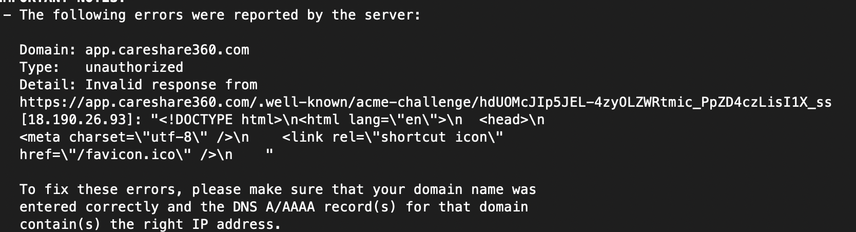

I was attempting to add the subdomain to my main server by running:
sudo certbot certonly --nginx -d www.careshare360.com,careshare360.com,app.careshare360.com --dry-run
I then received an invalid response from the .well-known/acme-challenge.

That’s the error when you tried to create a certificate containing the app subdomain on your www server, right? That’s normal and expected.
