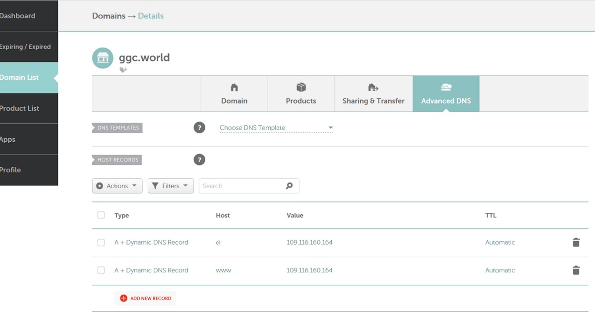

I realized that the public IP address given by my Internet Service Provider changed:
I then updated it in the NameCheap’s domain account:
