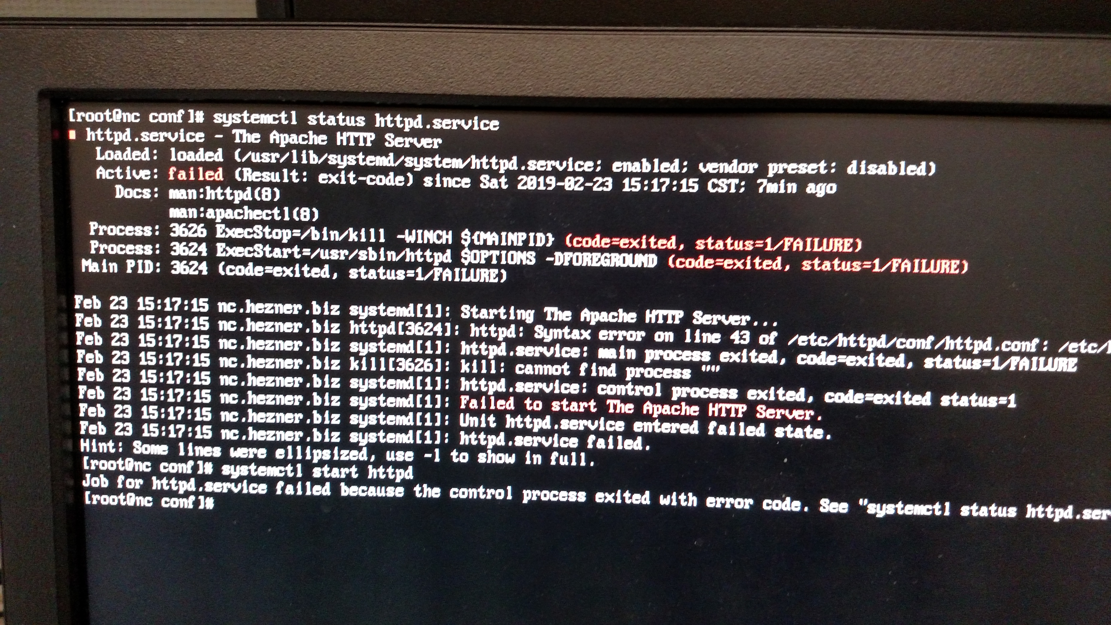

When i edit the httpd.conf to add those lines right after the ‘Listen 80’ line, save the file, and run systemctl restart httpd.service it fails. When I look at systemctl status httpd.service is shows the service as failed
When I comment out those lines and resave the file, then httpd.service will restart without any problem.
What's the content of line 43 in this file? There is a syntax error, but I can't see the details.
Line 43 of the httpd.conf file is where I wrote <VirtualHost *:80>

I uncommented the virtual host lines, saved and tried to restart httpd.service. It sill fails.
Here is a screen shot of where I’ve inserted the virtual host info. Do see the syntax error on the <VirtualHost *:80> line?

Upps - the end element of your screenshot looks wrong:
<VirtualHost>
instead of
</VirtualHost>
You caught my error. When I fixed that then httpd.service restarts OK.
