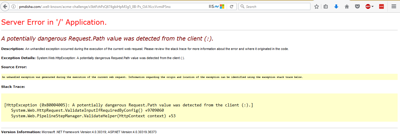

also assuming your domain is pmdisha.com
you should be able to browse to http://pmdisha.com/.well-known/acme-challenge/x5btFzhPzQ674gbiHpM3g5_8B-Ps_OA1KccVvmiP5ns:
when i do this i see this:
this tells me that an something is blocking the request, if certbot is not able to get the file then it will not validate your domain.

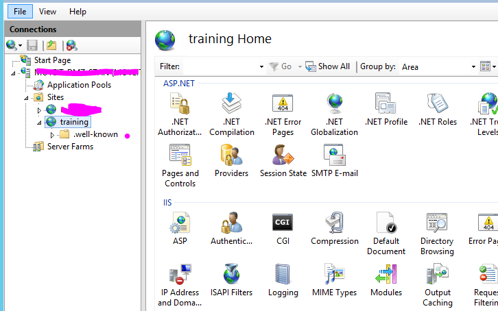

I am not sure if Plesk has uploaded the file but you should be able to verify this by browsing to the webroot of the site and seeing if there is a ./well-known folder
for example:
Andrei
