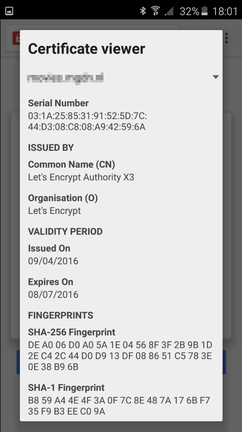

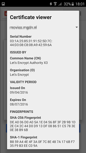

Hello. I see and read topic very carefully a 4 days ago, because I have exactly same problem. Is there any fix provided? We have a very unpleasant situation - we cant login via mobile devices in our web system.
Same here, Chrome and IE work just fine, but the checking sites like SSLabs gives an chain error. Also Mozilla Firefox doesn’t work. We just recently went for SSL because it was free. So was quite happy that it works so easily.
We work on Windows Server 2012 R2 with IIS 8.5.
Similar issue but for me Chrome on Android displays the invalid error.
Running sites on Windows 2012R2 IIS 8.5
Because of the limit of the number of images per post for new users :unamused: I need to post several replies.
Last image can be found here because of the post limit for new users I cannot post the last one :unamused:
