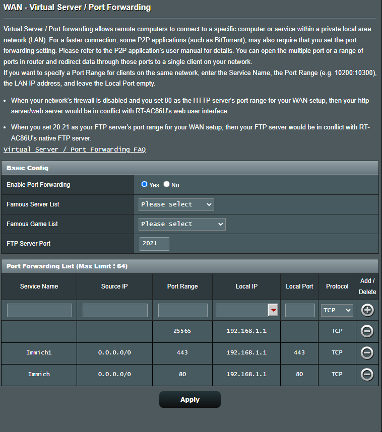

hope this added some more info, what is a nat evice? I did do something that used iptables, you can find it in the pastebin i tihnk

Usually there is a router device to which the internet is connected, providing WiFi and cable connections to all the devices in a house hold. It usually blocks all incoming connections, because it doesn't know what to do with them. And a "portmap" is required to point the ports (e.g. 80 and 443) to a specific device in the local network (e.g. a Raspberry Pi).

Is that from your home router? If so, this explains the behaviour I see. You should modify those 2283 to the corresponding 443 and 80 (so 443 -> 443 instead of 443 -> 2283 and 80 -> 80 instead of 80 -> 2283).
Because you want your nginx, running on port 80 and 443, to do the reverse proxying including the certificate and NOT directly let everybody connect to the Immich Docker instance.

once you've got your NAT portmaps in order, see below.
Yes. The outside world, like users and Let's Encrypt, should connect to your nginx webserver, NOT directly to Immich. Nginx is configured (once it's fixed) to reverse proxy everything to Immich locally and will take care of the certificate et c.

  Detail: 155.4.61.251: Fetching http://familjenisback.duckdns.org/.well-known/acme-challenge/jeLJLDGnkxjGqcemZpGuKMAgx6_KqA-A1nJJOS8bCPQ: Timeout during connect (likely firewall problem)
Can you show the settings of your router again (screenshot), how portmaps currently are configured?

Why has the destination (local) IP address suddenly changed from 192.168.1.55 to 192.168.1.1?
Oh thats my bad. I will fix that. the interface of the router settings page is bad.
I changed it to 66, tried again with the certbot command, but still no luck. The adress
doesnt seem to go anywhere now

Why not 55 like before? If your RPi has gotten a new IP address: it's recommended to set up a fixed IP address for servers like what you're doing right now.
This is a known issue with the quite bad DNS of DuckDNS.. Just try again. If it happens quite often, it's best to use the staging environment for testing first so you don't hit rate limits. When everything seems to be working, you can change back to the production environment again.
By the way, currently I see your port 80 open and port 443 closed (the latter is to be expected until you've got your certificate setup). So it seems your portmaps in the router are at least good at the moment. It's probably just DuckDNS being a pesky, bad DNS provider right now, hopefully temporarily.
Only weird thing is: I see a nginx welcome page.. Not Immich.. So for some reason your reverse proxy is not working.. Sigh.. Can you, next to the above, also provide the output of nginx -T again?
