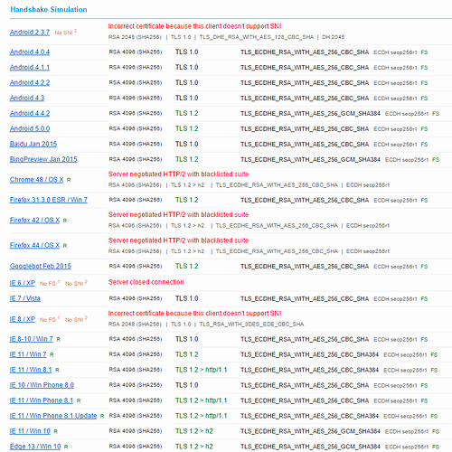

True, the ciphers mentioned here will give you a 100% Cipher Strength score in SSL Labs. I just did the test using the ciphers. SSL Labs did not penalize my score for using the ciphers but showed the warning: Server negotiated HTTP/2 with blacklisted suite. Using the ciphers might work now but might break in near feature releases of popular browsers.

I got A+ and 4x100% using DHE and RSA only, with none of that Elliptic Curve nonsense. It hammers the poor Raspberry Pi though (I'm waiting with bated breath for DHE + ChaCha20 + Poly1305 as Firefox doesn't appear to like AES256 with GCM, and uses AES256 CBC).

I think you’ll be waiting a while, browsers are deprecating DHE suites. Chrome only supports ECDHE suites now.
