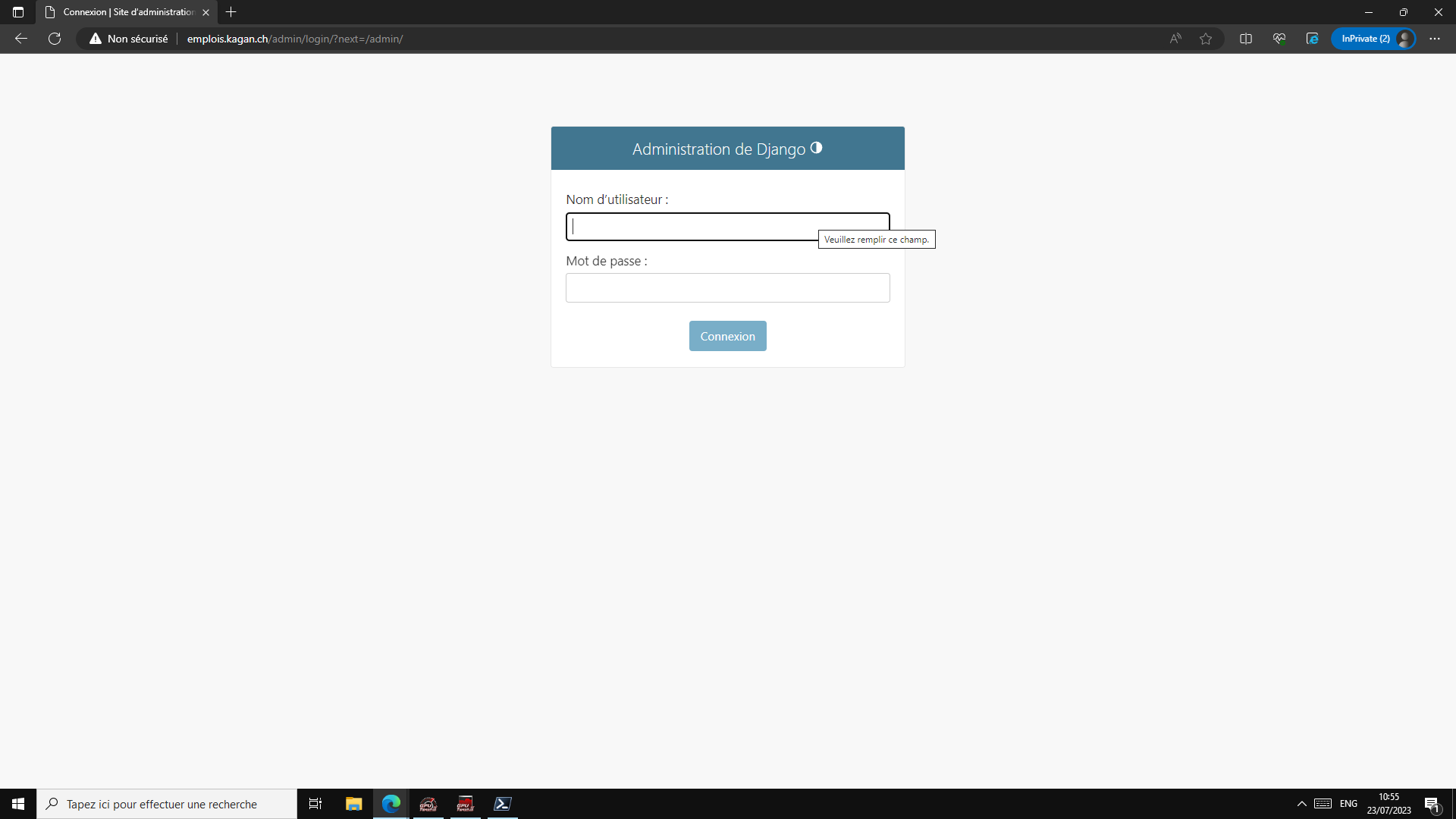

it works fine without DocumentRoot , it doesn't need the line. I am not really here to learn how Apache works, I am not complaining about Apache but I would like to know what to do to get lets encrypt to work. You can check out the webpages that I am looking to get letsencrypt certification here: http://emplois.kagan.ch or Connexion | Site d’administration de Django , there is not much traffic planned but the person I am working with viewing the website will panic and see oh the browser says it's insecure etc., so it would be nice to just get the certification so that we don't have this issue... also it would be nice to get the certification to know what to do should I want any future installation of django to be able to work. It after all wouldn't be fair if letsencrypt uses python but doesn't let others to do so but that does not seem to be the case.
