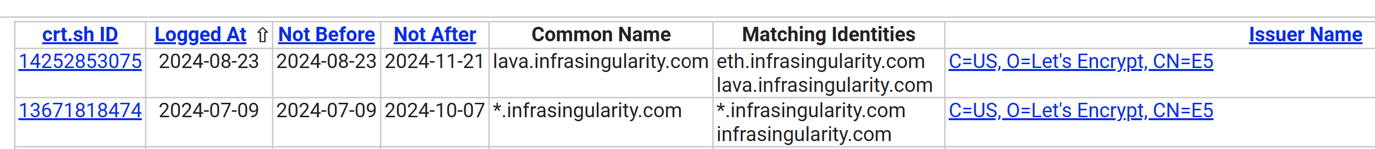

You, or someone, got a wildcard cert for your apex name on Jul9. Wildcards require a DNS Challenge so it worked before. And, requests to your apex show it using that wildcard cert.
Why do you think you need another cert for your apex domain? As @rg305 pointed out your apex uses Netlify (which uses AWS services) and what looks like a load balancer. Netlify probably manage that cert for you.
Your two subdomains (eth and lava) have DNS records that point directly to an nginx server. So, the methods available to get a cert for those are different than your apex.
