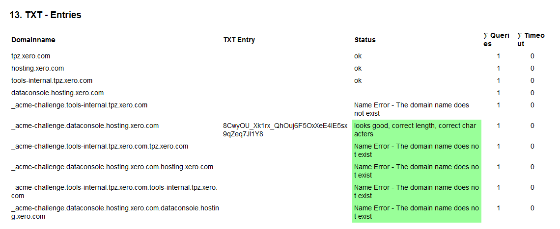

PS: Your TXT entry looks good - https://check-your-website.server-daten.de/?q=dataconsole.hosting.xero.com
