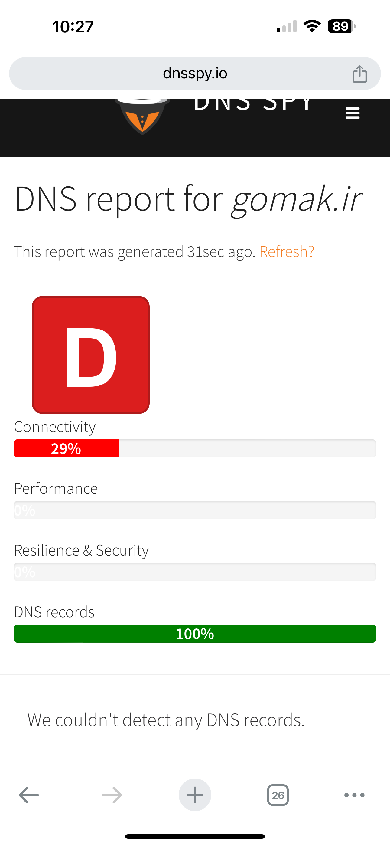

Here Hardenize Report: gomak.ir is showing DNS Zone errors
And here https://dnsspy.io/scan/gomak.ir
Yeah, you're going to want to fix your delegation and glue records, and make sure the DNS servers respond over TCP, before trying to debug anything else relating to the domain name.
