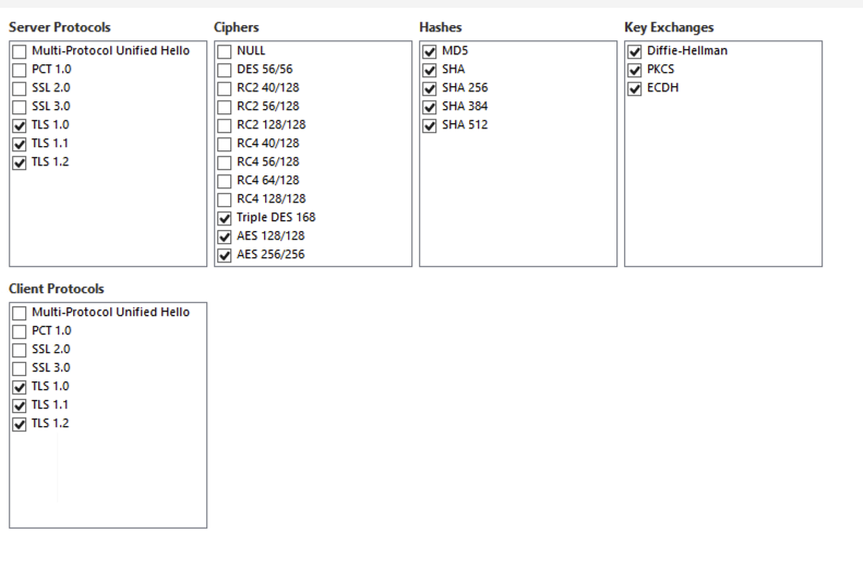

Which TLS protocol levels and ciphers suites are enabled in Windows? You can use IIS Crypto to check the current settings.
Hello.This topic was started by my colleague, he is now on vacation. Below I provide screenshots from IIS Crypto
Thanks, those settings look good (in that they are broadly compatible, there's a bunch of stuff that can be deselected to make things a little more secure but that's off-topic).
At this point I would probably just try a different CA instead of Let's Encrypt. How you do that depends on the ACME client software you decide to use.
saw that there is mention of TLS 1.3 which is not supported by windows server 2012r2
