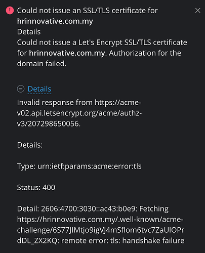

Could not issue an SSL/TLS certificate for my domain (hrinnovative.com.my)
cloudflare breaks TLS on their edge, and they do tls handshake themselves. so your backend TLS-alpn-01 solver doesn't touched. try dns-01 with cloudflare api token

As far as I can tell
  • the domain is: hrinnovative.com.my
  • the web server is: cloudflare
Here is a list of issued certificates crt.sh | hrinnovative.com.my, the one and only on 2023-03-01 by C=US, O=Google Trust Services LLC, CN=GTS CA 1P5
And using this online tool https://www.redirect-checker.org/ you will see an infinite redirect for https://hrinnovative.com.my/.well-known/acme-challenge/sometestfile

Actually Let's Debug is probably even better showing BadRedirect ERROR https://letsdebug.net/hrinnovative.com.my/1392313
That kind of HTTPS to HTTPS redirection loop (301) can be caused by having the CDN configured to connect to the backend server via HTTP.
And the backend server returns the 301 redirection which is passed to the originating request [but that request was already HTTPS - it is the CDN that needs to be configured to use HTTPS (it won't follow the redirection - it merely passes it on)].
