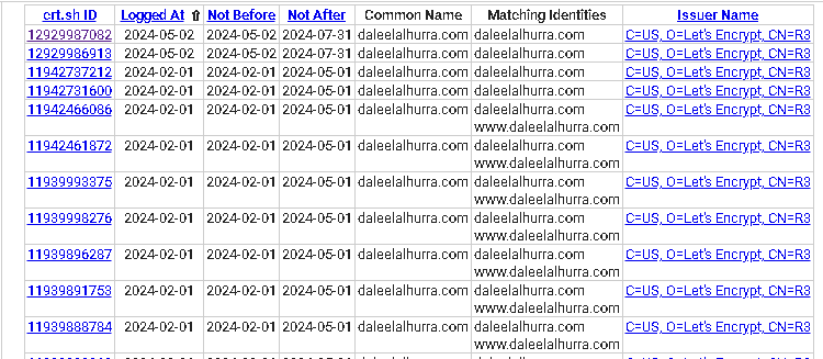

Side note: here is a list of issued certificates crt.sh | daleelalhurra.com
Recently your certificates only have the name daleelalhurra.com;
a while back they had both the name daleelalhurra.com and the name www.daleelalhurra.com.
