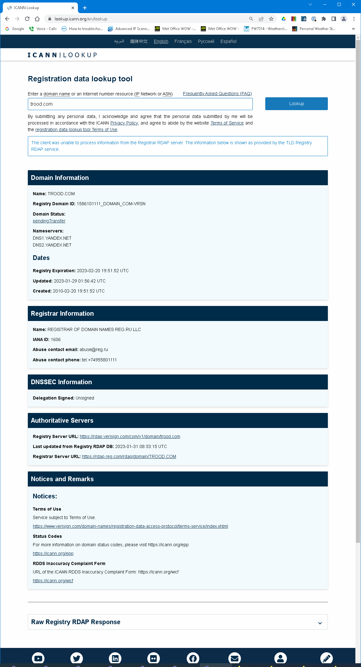

Global DNS still shows:
trood.com       nameserver = dns1.yandex.net
trood.com       nameserver = dns2.yandex.net
Yes @rg305 you are correct, thanks! :slight_smile:
Raw Registry RDAP Response
   "objectClassName": "domain",
   "handle": "1586101111_DOMAIN_COM-VRSN",
   "ldhName": "TROOD.COM",
   "links": [
         "value": "https://rdap.verisign.com/com/v1/domain/TROOD.COM",
         "rel": "self",
         "href": "https://rdap.verisign.com/com/v1/domain/TROOD.COM",
         "type": "application/rdap+json"
         "value": "https://rdap.reg.com/rdap/domain/TROOD.COM",
         "rel": "related",
         "href": "https://rdap.reg.com/rdap/domain/TROOD.COM",
   "status": [
      "pending transfer"
   "entities": [
         "objectClassName": "entity",
         "handle": "1606",
         "roles": [
            "registrar"
         "publicIds": [
               "type": "IANA Registrar ID",
               "identifier": "1606"
         "vcardArray": [
            "vcard",
                  "version",
                  "text",
                  "4.0"
                  "fn",
                  "text",
                  "REGISTRAR OF DOMAIN NAMES REG.RU LLC"
         "entities": [
               "roles": [
                  "abuse"
               "vcardArray": [
                  "vcard",
                        "version",
                        "text",
                        "4.0"
                        "fn",
                        "text",
                        "tel",
                           "type": "voice"
                        "uri",
                        "tel:+74955801111"
                        "email",
                        "text",
                        "abuse@reg.ru"
   "events": [
         "eventAction": "registration",
         "eventDate": "2010-02-20T19:51:52Z"
         "eventAction": "expiration",
         "eventDate": "2023-02-20T19:51:52Z"
         "eventAction": "last changed",
         "eventDate": "2023-01-29T01:56:42Z"
         "eventAction": "last update of RDAP database",
         "eventDate": "2023-01-31T16:33:15Z"
   "secureDNS": {
      "delegationSigned": false
   "nameservers": [
         "objectClassName": "nameserver",
         "ldhName": "DNS1.YANDEX.NET"
         "ldhName": "DNS2.YANDEX.NET"
   "rdapConformance": [
      "rdap_level_0",
      "icann_rdap_technical_implementation_guide_0",
      "icann_rdap_response_profile_0"
   "notices": [
         "title": "Terms of Use",
         "description": [
            "Service subject to Terms of Use."
         "links": [
               "href": "https://www.verisign.com/domain-names/registration-data-access-protocol/terms-service/index.xhtml",
               "type": "text/html"
         "title": "Status Codes",
         "description": [
            "For more information on domain status codes, please visit https://icann.org/epp"
         "links": [
               "href": "https://icann.org/epp",
               "type": "text/html"
         "title": "RDDS Inaccuracy Complaint Form",
         "description": [
            "URL of the ICANN RDDS Inaccuracy Complaint Form: https://icann.org/wicf"
         "links": [
               "href": "https://icann.org/wicf",
               "type": "text/html"

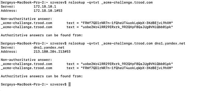

Sorry - as I said above - the yandex.net support made me to change _acme-challenge.em to _acme-challenge, which apparently did not work through
The dns1.yandex.net aswer is still non-authoritative
I mean I've put TXT record _acme-challenge directly to dns1.yandex.net records, and it is still a non-authoritative answer (as on the screenshot above)
There are for the domain name trood.com not the domain name em.trood.com
$ nslookup -q=txt _acme-challenge.trood.com dns1.yandex.net.
Server:         dns1.yandex.net.
Address:        213.180.204.213#53
_acme-challenge.trood.com       text = "uobe2Wz4lRR29ERxrk_9R2QHpF8QaJUg0VNiQbb01pk"
_acme-challenge.trood.com       text = "FRWf7QDlrNR7n-1fQheUT4uokLqWpX-3KdBEjvL9hXM"
$ nslookup -q=txt _acme-challenge.trood.com dns2.yandex.net.
Server:         dns2.yandex.net.
Address:        93.158.134.213#53

What is 172.18.10.1?
What does that server have to do with your authoritative DNS servers?
Looks like the closest to me DNS. Just turned off the proxy, and can see the US address
Yes, as I said I just had to follow the DNS provider support recommendation, to show them it's not working.

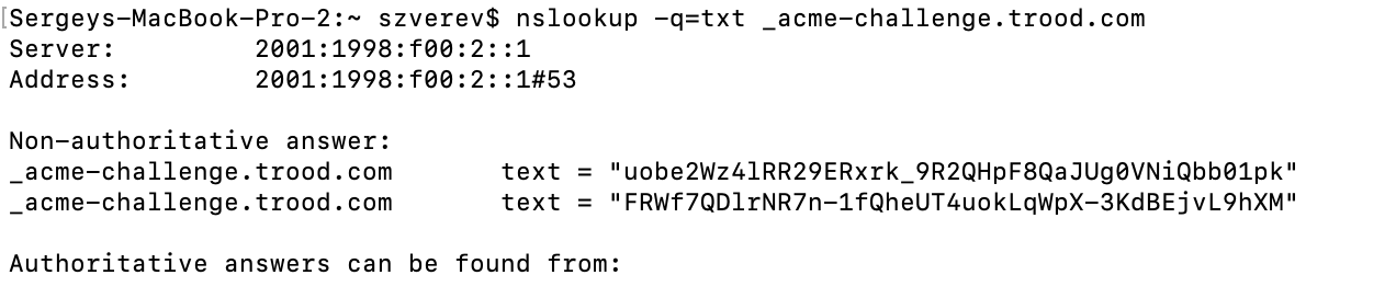

So now the txt is _acme-challenge.trood.com, but the answer of dns1.yandex.net is still non-authoritative
Please show the command and output of this "non-authoritative" result.

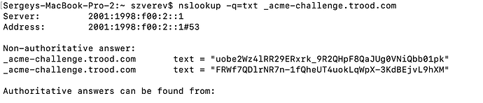

as on the screenshot above:
szverev$ nslookup -q=txt _acme-challenge.trood.com
Server: 2001:1998:f00:2::1
Address: 2001:1998:f00:2::1#53
Non-authoritative answer:
Authoritative answers can be found from:
This nslookup will use your default name server
Where this I told it to use dns1.yandex.net. as the name server.
There are tens of thousands of DNS servers on the Internet [if not more].
With regards to your specific DNS request, their replies can be grouped into five distinct categories:
  1. You've reached an authoritative DNS server for that zone and it replies as such.
  2. You've reached a DNS server that is not authoritative for that zone and can recursively reach the answer for you and does so - returning a non-authoritative result.
  3. You've reached a DNS server that is not authoritative for that zone and refuses to recursively look for the answer for you - it returns "Query Refused".
  4. You've reached a DNS server that is not authoritative for that zone and is nice enough to point you in the right direction - and it returns some root hints towards your requested zone.
  5. You reached a non-working DNS server and your querries will go unanswered.
You seem to be doing #2.
When you should be doing #1.
