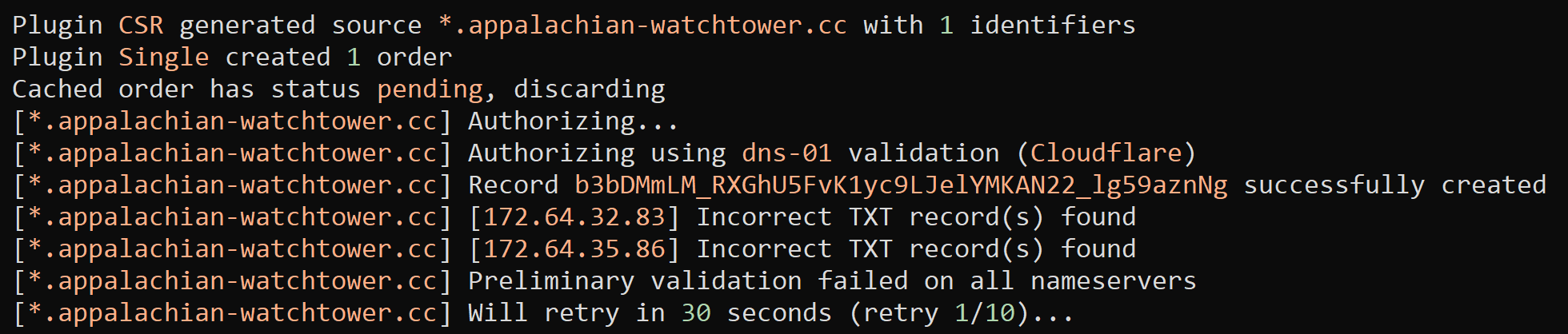

Cannot run DNS-01 test through Win-ACME
My domain is: appalachian-watchtower.cc
I ran this command: Create certificate (full options) > CSR created by another program > path to private key > path to csr file > single certificate > create verification records in Cloudflare DNS > API token > Windows Certificate Store > Web Hosting > No (additional) store steps > Create or update bindings in IIS > Default Web Site > No (additional) installation steps
Plugin CSR generated source *.appalachian-watchtower.cc with 1 identifiers
Plugin Single created 1 order
[HTTP] Request completed with status BadRequest
Error requesting certificate Appalachian_Watchtower
My web server is (include version): Local computer
The operating system my web server runs on is (include version): Windows 11
I can login to a root shell on my machine (yes or no, or I don't know): I don't know
The version of my client is (e.g. output of certbot --version or certbot-auto --version if you're using Certbot): Win-ACME 2.2.9.1701
Using the same method I'm using now before, I was able to at least get Let's Encrypt to recognize my DNS-01 challenge attempt and generate a record on Cloudflare. From there, it would generate this message:
I think this was happening because I needed to delete the _acme-challenge TXT record I created while the test was in progress to ensure there was only one, but when I tried to implement that solution today, it didn't even get as far as generating the record. Could this be a rate limit issue? If not, is there anything I can do?

You could add --verbose to your wacs command for more details of the error. The error is from the wacs preliminary validation. It is not a Let's Encrypt error. wacs checks your DNS TXT records before submitting cert request to LE. I don't see anything wrong in your DNS config and Cloudflare usually syncs fairly quick (less than a minute). So, nothing obviously wrong.

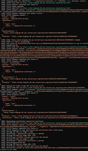

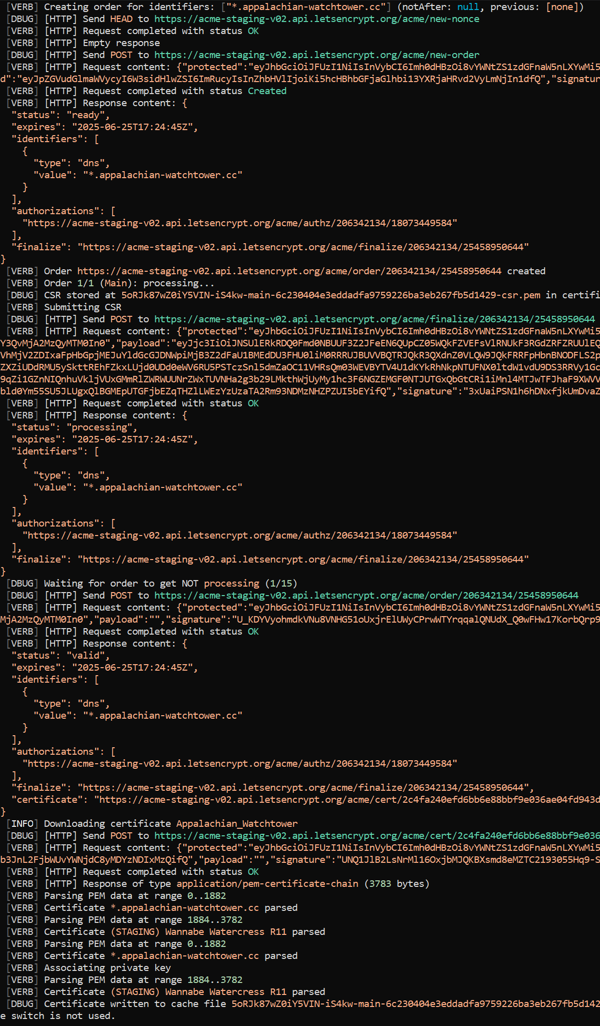

I checked --verbose mode and found there was a badCSR error, which I think I corrected by generating a new CSR through OpenSSL commands rather than the IIS Manager. Here's the script I used:
openssl req -new -newkey rsa:2048 -nodes -keyout private.key -out request.csr
After changing this, I was able to generate a certificate in my Web Hosting folder in the Windows Certificate Store. However, based on the output, I am not sure if the DNS-01 challenge actually happened.
I wasn't able to find the line "Authorizing using dns-01 validation (Cloudflare)" anywhere in the verbose output, and my DNS records on Cloudflare were not updated, even though I selected Cloudflare as my method for proving ownership of the domain.

The verbose output was from a test using the Let's Encrypt Staging system. I also do not see the challenge issued. So, you probably had a valid authorization cached in the LE Staging system for that domain and your ACME account. Cache is 30d.
The second part of that test was for the LE production system. Does not use the same cache as LE Staging (but will cache production authorizations).
I see from the public CT log history you got two certificates today from the Staging system and two from production. So, the first from each would have needed to validate but the second would succeed without one because of this cache.
In any case, you have a new production Let's Encrypt cert so all should be well.
